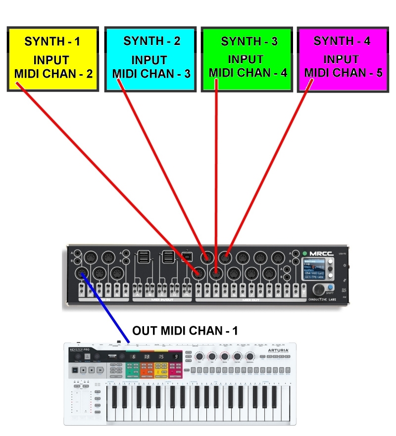

Test this setup:
Keystep-PRO = output on MIDI channel - 1
Connect Keystep-Pro to MRCC to input port - 1 (left)
Because i also use sequencer like Polyend SEQ and OXO-one who use differ MIDI channels while playing GRID as voice or harmonic function
SYNT-1 = output on MIDI channel - 1
SYNT-2 = output on MIDI channel - 2
SYNT-3 = output on MIDI channel - 3

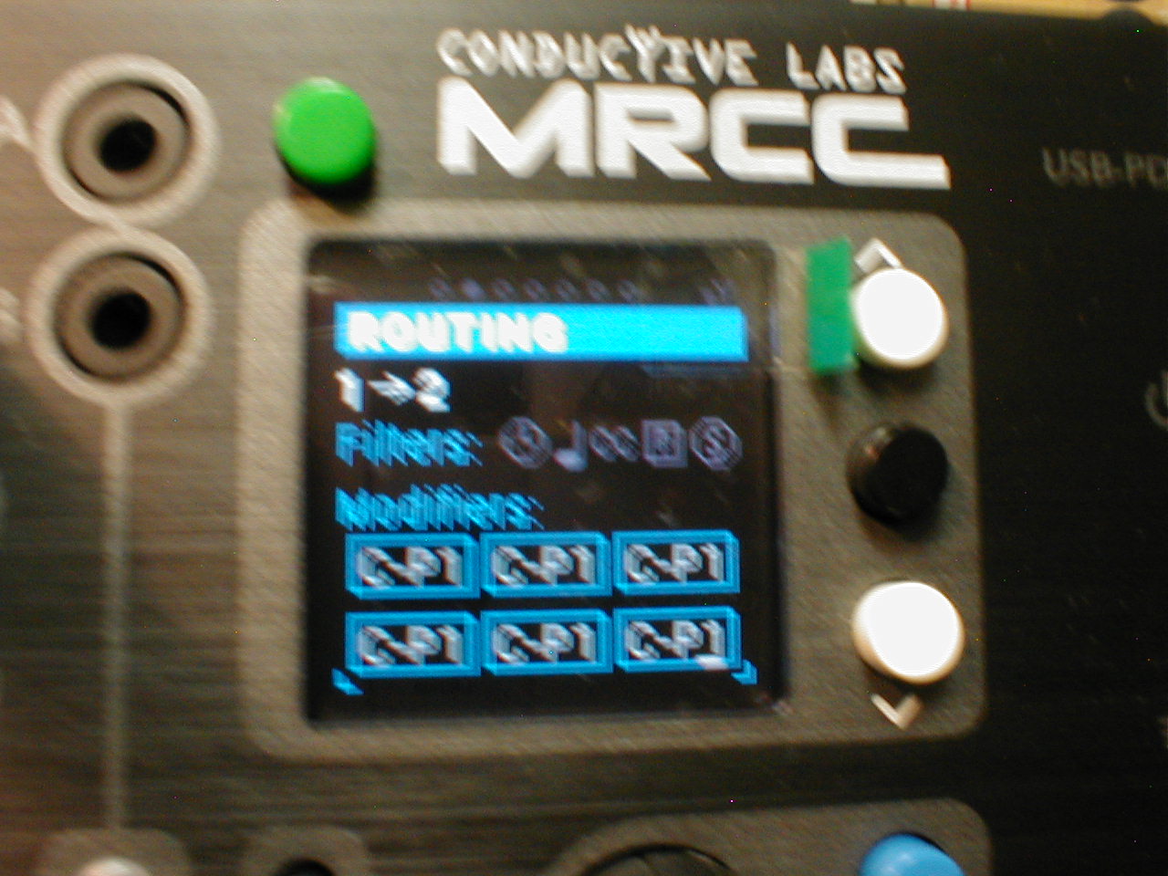

SYNT-4 = output on MIDI channel - 4
MRCC igo to:
ROUTING  settings

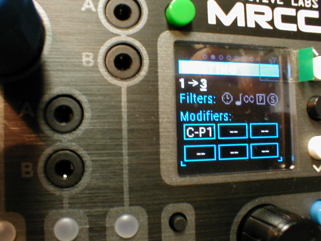

1 -> 1  set C-P1  in all 6 boxes  and synt - 1 playing OK
1 -> 2  set C-P1  in all 6 boxes  and synt - 2 not play
1 -> 3  set C-P1  in all 6 boxes  and synt - 3 not play
1 -> 4  set C-P1  in all 6 boxes  and synt - 4 not play
1 -> 5  set C-P1  in all 6 boxes  and synt - 5 not play

Hi Jesse,
Using  the latest FW

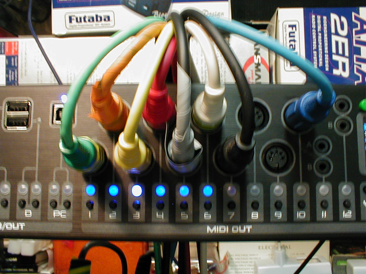

Reply i send with pictures about the settings i try but not function
Contact some  YOUtube channels to ask  if they able to test the setup,  but most of those only do promotional work to get free hardware  Smile
Also contact Thomann,  to see if Thomann able to connect hardware and reproduce this matter.  Thomann not have/use MRCC in there studio but advice me to try using MOD menu because this is not a special setup but very common any midi merger is able or can do this. But no one is able actual test it.......... on MRCC.
Also on this user forum, no  hints / advice from other users.
MRCC only do input  MID-1 to output MID-1,
MRCC only do input MID-2 to output MID-2,
MRCC only do input MID-3 to output MID-3,
And wish MRCC is forwarded  pass tru  or merge to  differ other midi channels and i not able to get it functional.
MRCC like do input  MID-1 to output MID-1,
MRCC like do input  MID-1 to output MID-2,
MRCC like do input  MID-1 to output MID-3,
MRCC setup to MIDi TRU?
MRCC  setup to MIDi merge?
Is this possible?  Is it bug?  Or, what i do wrong that not get functional?
Thank you

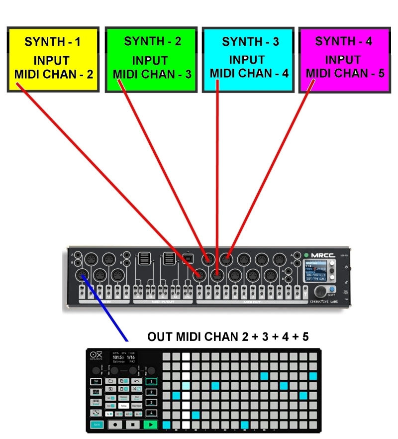

I make drawing only to get the idea as part of my setups  using sequencers OXi one and Polyend SEQ total of 16 differ MIDI channels  as 1 to 16 Using many many DIN cables  So you all understand  why i like using the MRCC  with the switch  buttons

You have 2 ways to solve this routing.
First, Go to the Router Screen Page.
On the first screen 1 -> 1 Move to the empty boxes.  Select the MOD C-P1
Move the cursor and change 1 -> 1 to 1 -> 2.  Select MOD C-P1
Move the cursor and change 1 -> 2 to 1 -> 3.  Select MOD C-P1
Do this for all the ports you are using.
NOW - go to every synthesizer and set the MIDI Input channel to Channel 1.
Your sequencers will send MIDI messages on channels 1-16, the MRCC will send Channel 1 to output port 1, channel 2 to output port 2, channel 3 to output port 3, and so on.
The second method is to use Channel filtering.
Go to the Channel Map screen.
For Chan Map #1, set it like this:
Exclusive: Y
1 Ch In: 1    Out: 1
2 Ch In: 14  Out: 14
3 Ch In: 15  Out: 15
4 Ch In: 16  Out: 16
Now cursor up to #1 and change it to #2.  Set it up like this:
Exclusive: Y
1 Ch In: 2    Out: 2
2 Ch In: 14  Out: 14
3 Ch In: 15  Out: 15
4 Ch In: 16  Out: 16
Do the same for #3, #4, #5, #6
Some day they will add the feature to select In: None, but it is not there in OS 1.1.052, so I just set them to unused channels.
NOW - go to the Routing Screen Page.
For Route 1 -> 1, add MOD Ch1
cursor to the output port and change 1 -> 1 to 1 -> 2
Add MOD Ch2
change 1 -> 2 to 1 -> 3 and add MOD Ch3
This works for 6 channels only since you can only create 6 channel mods.

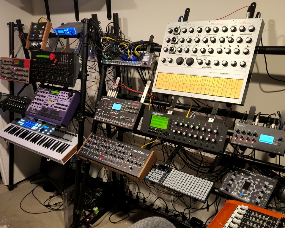

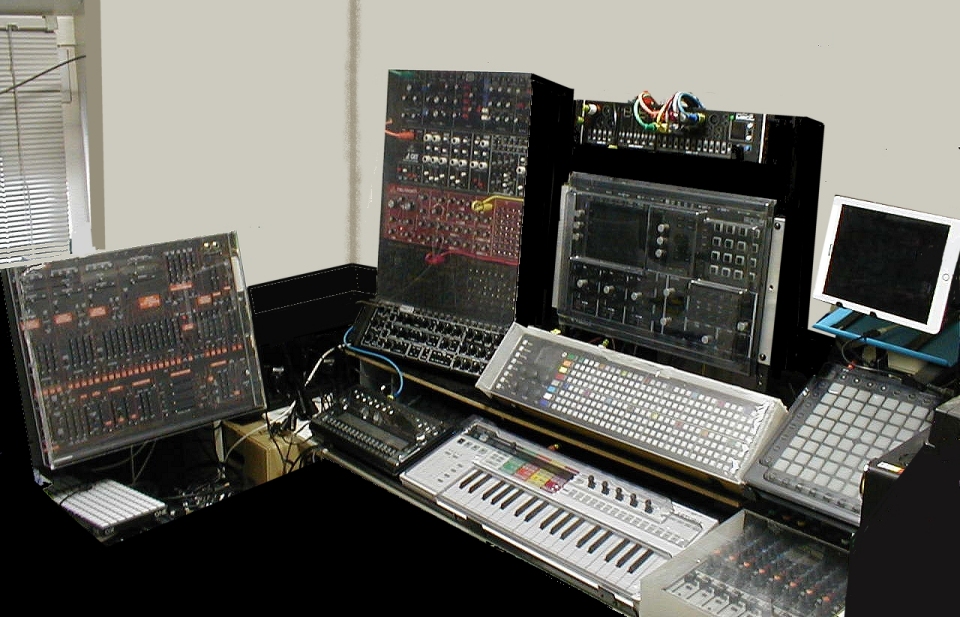

My setup is also complex with multiple sequencers and because I have some multi-timbral synthesizers, I use a combination of both ways to configure the port filtering.
Here is part of my setup:
Attached Files Thumbnail(s)

Thank you, i will try your advice this weekend  it look like we both use very large hardware setup  and my wish the MRCC will be the best to control them all.
This i my setup picture from july 2022 all in 19" rack
Right topside, you see MRCC in 19" rack
OXI-one on left down on the box, but not connected
in total  use 10 hardware Syth  no DAW  no PC
all hardware connected with MIDI DIN using there own input and output MIDI channel play there own sound/song/melody but simultaneous.
The Polyend SEQuencer  is the main base controller for 8 Synthesiser,  using the MIDI channels simultaneous 1 2 3 4 5 6 7 8  per sequencer grid ROW.
