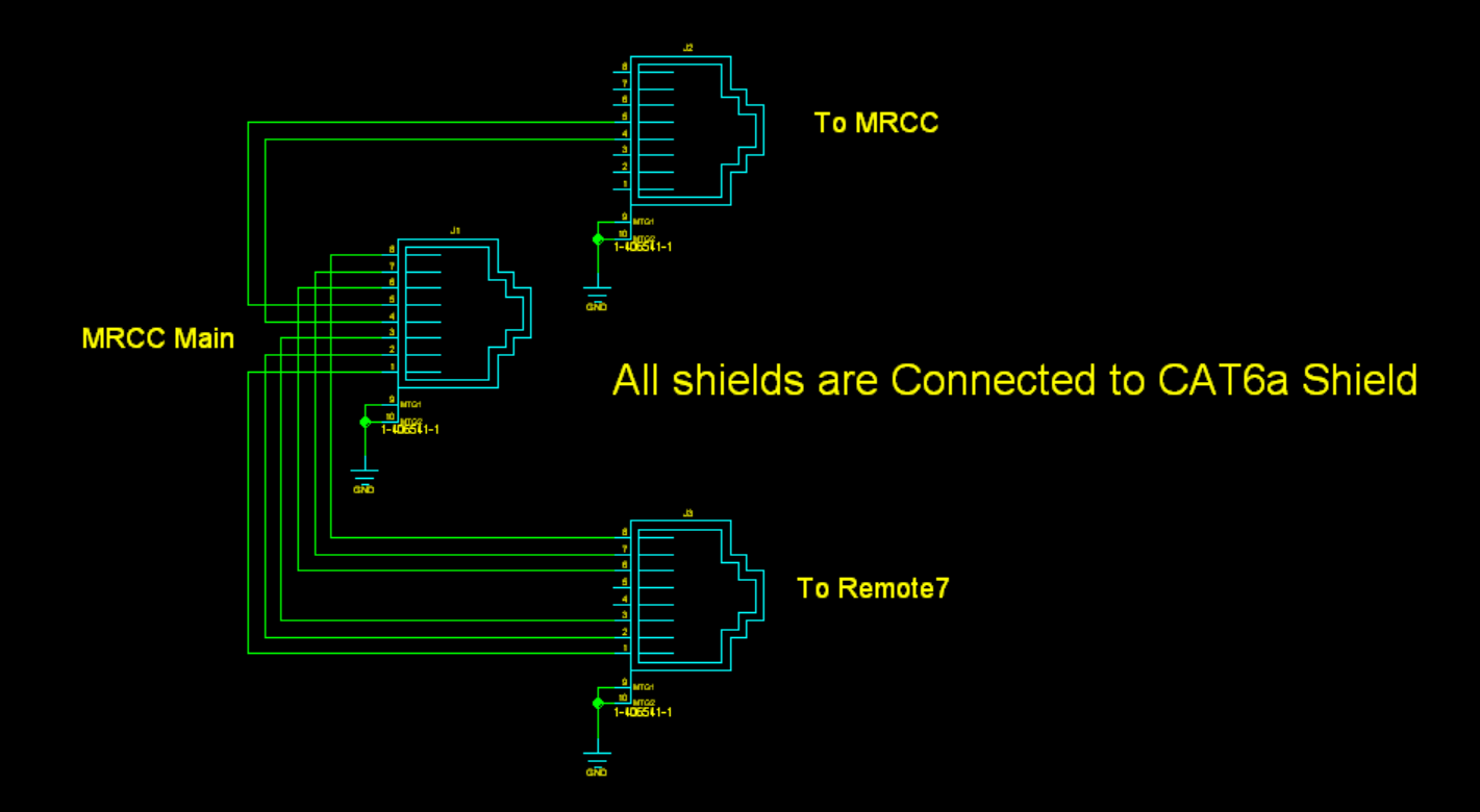

Modify the Splitter
On the side of the splitter with two RJ45 connectors, on the left side connector, use some electronics tweezers to lift 3 pins on the left side and 3 pins on the right side. Pry the pins up so they are vertical, being careful to leave the middle 2 pins intact.
Trim those 6 pins off with flush cutting wire cutters. Trim them as close to the housing as possible.
Here's how mine looks after trimming the 6 pins off, you can see the two pins left in the middle:
That's it! Now use a shielded CAT6a cable to attach the first MRCC to the single connector side of the splitter.
Attach the other MRCC using the connector where the 6 pins were removed.
Attach the Remote 7 with a shielded CAT6a cable to the connector with all the pins.
Here's mine... the white wire is going to the MRCC that will use the Remote 7 outputs. The green wire is going to a Remote 7 on my keyboard stand. The black wire is going to an MRCC in a 19 inch rack.
We tested connecting the MRCCs with shielded CAT6a cables, like the one we supply with the Remote 7. However, for a short run of 6 to 10 feet, you can probably get away with an MRCC to MRCC connection using a regular CAT5 cable if that's all you have. YMMV
The cable from MRCC to the splitter, and splitter to The Remote 7 requires the shielded cable for any length, the kind with metal shrouded connectors.

The Remote 7 will only be attached to the MRCC that is on the single connector side of the splitter. In this configuration, the Remote 7 can only act as MIDI thru ports for MRCC Outputs 1-5. The Remote button on MRCC will be used to route to the other MRCC's outputs.
The purpose of the splitter modification is to disconnect the Remote 7 from the 2nd MRCC. The 6 pins that are being removed are 5 MIDI outputs and 5V DC. Otherwise, we'd be connecting 5V to 5V and MIDI outputs to MIDI outputs, which wouldn't break anything, but the Remote 7 wouldn't work.
Theoretically, you could put a splitter on both sides so both MRCC's could have Remote 7s.
Reply
#5
If you are wiring your own splitter, this is the optimal configuration.
The shielded connectors are not optional. The Remote 7 requires the shield as a ground path to MRCC.

We also found that its not always easy to identify the shielded cables on some shops. If its labeled CAT6a (or greater) Shielded, that is a pretty good sign. The best indicator is that it has the metal shroud over the connectors. Those are the shields we need and are what connects ground from MRCC to Remote 7. The shields on the connectors must be connected to each other via a drain wire in the Ethernet cable. I don't know why anyone would use shielded connectors and not connect them, but you never know. Best to stick with reputable suppliers.
You will need to connect each MRCC to the computer, one at a time, to do FW updates.
They can both be connected by USB to your computer if you need both showing up in your DAW. That would be the most efficient way to route to specific outputs from the DAW, rather than routing from the DAW to the first MRCC, then routing to the other MRCC. That's more complication and adds an extra hop that will add latency.
Jesse is correct, in our experience, as long as you trim the pins close to the socket housing its good enough. If for some reason the trimmed pin is touching a pin on the cable, it would only cause one of the MIDI ports on Remote 7 to malfunction. It won't physically damage anything. In that case, maybe try filing the pins down further with a nail file.
