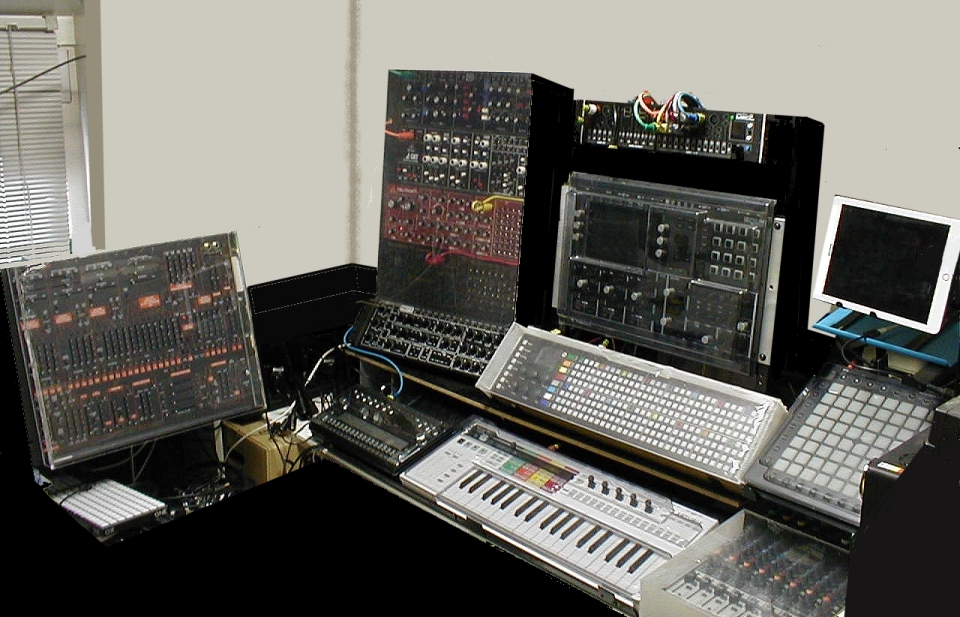

This i my setup picture from july 2022 all in 19" rack
Right topside, you see MRCC in 19" rack
OXI-one on left down on the box, but not connected
in total use 10 hardware Syth no DAW no PC
all hardware connected with MIDI DIN using there own input and output MIDI channel play there own sound/song/melody but simultaneous.
The Polyend SEQuencer is the main base controller for 8 Synthesiser, using the MIDI channels simultaneous 1 2 3 4 5 6 7 8 per sequencer grid ROW.
It look when i setup your last routing settings while using the PolyendSEQ,
i lost play MIDI channel 2 3 4 5 6 7 8 and only hear all synthesisers play polyendSEQ MIDI channel 1?
Is this correct?
Is this correct?
