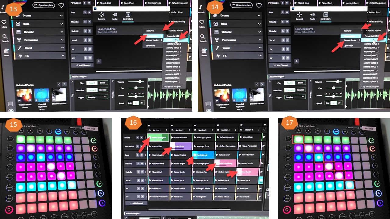

Step 12
Open Ampify Studio (or Ableton Live or any other DAW) and configure the Launchpad Pro as controller. The Launch Pro is displayed but disconnected.
Step 13
Click on the 3 dots and select MRCC as the input device
Step 14
Select the MRCC as the output device
Step 15
Open a Sound Pack in Ampify Studio, select open template and the layout of the Launchpad should reflect the sounds in Ampify Studio.
Step 16
Select a few sound in Ampify Studio
Step 17
The Lauchpad should highlight the playing sounds. Now you can also control Ampify Studio from the Launchpad Pro
