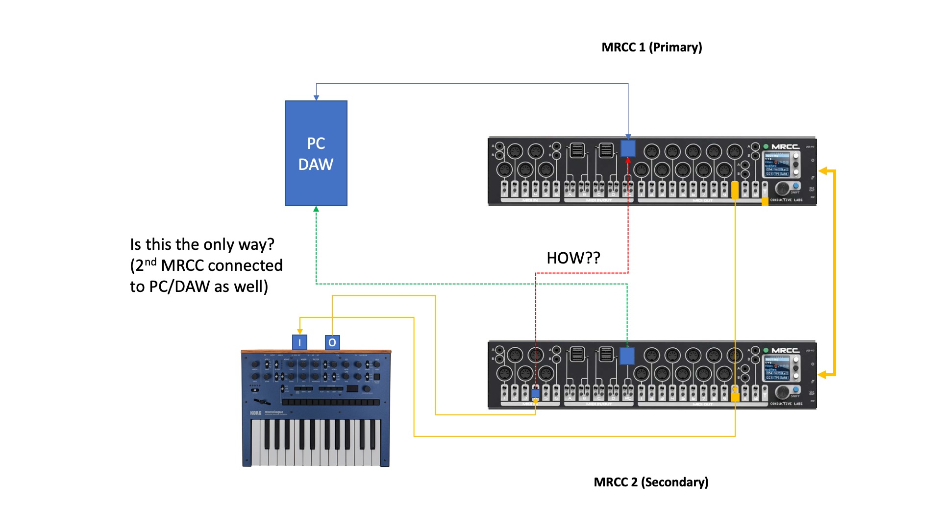

Hello,
I have a question regarding if it is possible to route hardware synth midi (via 5pin) to the PC/DAW from a 2nd MRCC (as follower) over to a 1st MRCC (as leader connected directly to the PC)? Both MRCCs are connected bi-directionally via the ethernet. I have prepared a quick diagram to explain such a scenario. I would rather not have to plug the 2nd MRCC into the PC if I don't have too.
Cheers,
Dan

#2
Hey Dan,
I don't actually know whether this will work or not, but I'll look into it and find out for you. Be back with an answer probably tomorrow.

#3
Answer is -- yes it works.
Couple Tricks --
Routing Synth out through MRCCs -
hold down the 'Y' button on Secondary MRCC.
Select Port 4 (input), press AND HOLD PC out button (LED should be yellowish) -- ALSO press another output port (1-12). This will be the port the DAW sees.
Release 'Y' button. No output LEDs should be on.
Hold Y button again - PC Out LED should be on.
You should be able to play the synth and the DAW should see the data.
Return path:
On the Primary MRCC Select PC in port, - make sure to choose the same port number (1-12) that the DAW is transmitting on
Press and hold the Y button, select output port 10.
Play the DAW recording and the synth should see it.

One thing that really helped was - on the computer, start up MIDI Monitor/MIDI-Ox and have it monitor all 12 input ports.  Make sure nothing else is sending to the MRCC and it'll help you get the synth->computer path worked out

The big thing to remember even with the "Y" routing is that whenever you target a PC port (in or out) or a 4x1 (input) port you *have* to select the actual port number as well as the meta-PC port selection.

(08-13-2022, 07:09 AM)nexgenmusic Wrote: It works! Thank you!!!!
Dan
Excellent.   Thanks for reporting back.
Glad we could help.
