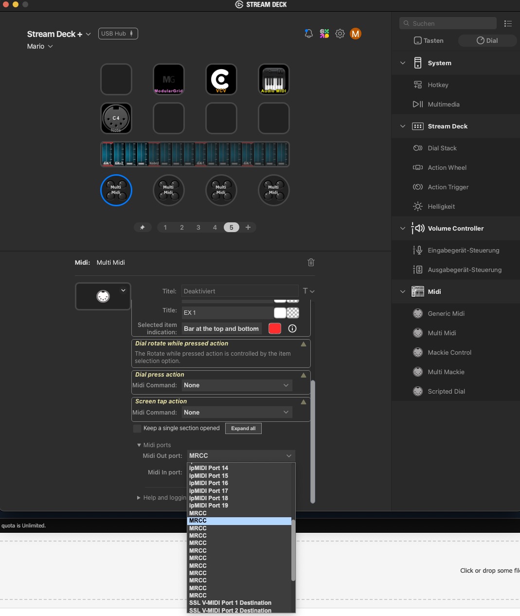

MRCC with StreamDeck Midi plugin - reltated to Midi Port Naming - MR.E - 01-06-2025 Hi Darryl, MRCC + remote7 + 4x xpandr Stream deck+ and stream deck xl Macbook M1 2020. ventura 13.7.1 recently i added a streamdeck + (with the encoders) and tried to programm Midi cc across multiple mrcc PC-ports apparently the stream deck midi plugin is confused because all mrcc ports are named "mrcc" without any numbering - streamdeck displays that i selected the second or third mrcc port in the list (see screenshot) but outputs midi only on first port, no matter the setting - streamdeck works fine as soon as i use ports where the ports are named differently. (ipmidi for instance) i read that was an issue before, i tried 1.1.075 and 1.1.077 which still appear without any portnumbering can this be set somewhere (hacking a config file or the like) or can you pls revert back to mrcc-1...mrcc-x numbering thank you mario RE: MRCC with StreamDeck Midi plugin - reltated to Midi Port Naming - Jesse Johannesen - 01-15-2025 Hey Mario, another user reported this as well (not in that software specifically, but on Mac), they found a work around that seems to work. In the Audio MIDI setup menu of the Mac, they created virtual ports with the numbered names and routed them into the inputs and outputs in that menu. Then in the DAW they connect to the new numbered ports which forward the data to the MRCC on the correct port. I will ask someone to pursue a better solution, but I don't know what kind of time frame that might happen in. In the mean time give this work around a shot. Jesse |
